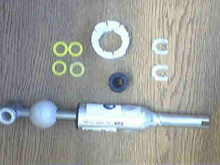

    Short Shift part? Please help
    What do these
    Replace in
  • McCoolidge
    • 226
    They go on the end of the shifter, In where the selector rod goes into the shifter. You take out the white bushings and put those in.
    • Mastrcruse
      • Sep 2005
      • 5340
      Do they help?
      • Mastrcruse
        • Sep 2005
        • 5340
        Are you sure? On the website it looks like it is replacing the rubber black piece in the middle which goes on the front of the linkage
          Im pretty sure McCoolidge is right. I don't have a whole lot of experience on these cars as of now. But on my vw rabbit the shifter setup was the same way. Those go on the bottom on each side and a bolt goes through them usually holding the linkage on. Hope this helps.

            Go to product catalog, BMW products and then go to short shifters
            Go to parts in detail and hit delrin carrier bushings and look at the animation.
            Not sayin you guys are wrong I am just confused by what you are telling me and how I am interpreting the website.
            Thanks

              neg, they go on the rear of the tranny, that white bushing is already stiff whereas the rubber is really soft

                so it is the black rubber bushing in the middle of the pic correct?

                  Yes, those replace the rubber black piece: they are carrier bushings.
                  They do help some. The carrier flexes; these will eliminate that flex completely.

                    So instead of TCD doing it for $150, The BavAuto place here will do install the whole thing for $40.
                    I just need to make sure....The UUC bushings (black) in the first thread replace Part #2 in this picture correct?
                    http://realoem.com/bmw/showparts.do?...74&hg=25&fg=05
                        http://www.uucmotorwerks.com/
                        Thanks
                        yes they replace the carrier bushings on the back of the tranny. if you click on youre own link then go back to that animation look on the left bar they have the directions on how to install the shifter and they show you where they go!
