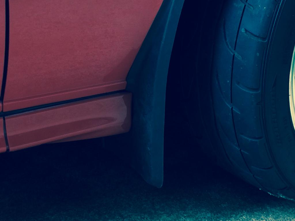

    Anyone know if it's possible to have IS sideskirts and mud flaps on the front?

    • beta14ok
      • 283
