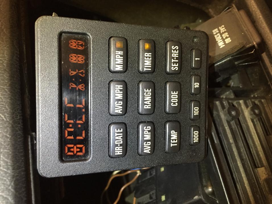

    I switched the 4-6 coding plug from the original OBC to the new OBC and plugged it in. I can tell the unit has power because the LCD did display line segments and the backlight bulb lit up. While the LCD displayed something, it really didn't display anything useful. Mostly constant, non-flickering gibberish, wingdings, whatever you want to call it. None of the buttons do anything to change the display, not even the reset button. One time while cycling the power through the ignition switch the OBC displayed '----UHR', but no buttons would change anything on it, and when I recycled power it went back to gibberish and then nothing, then small line segments.

    Here's a photo of what comes up on the screen when the unit is plugged in. Nothing changes when the key is turned nor when the illumination light is activated.
    ****Sorry for the rotated photo, I don't know how to change it. It doesn't really matter though because there's noting useful on the screen anyway.******
