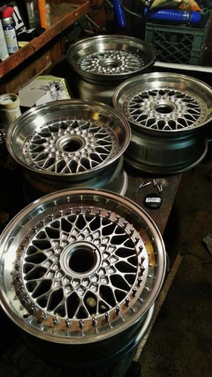

    When I did my my RSs I used a heavy duty paint remover to get rid of the remaining clear coat. Next i started sanding with like a 400 grit depending on how bad the wheel surface is. Work up to 2000 then hit it with some polishing compound. If you spend enough time they will look like mirrors. This takes a lot of sanding if done right.
