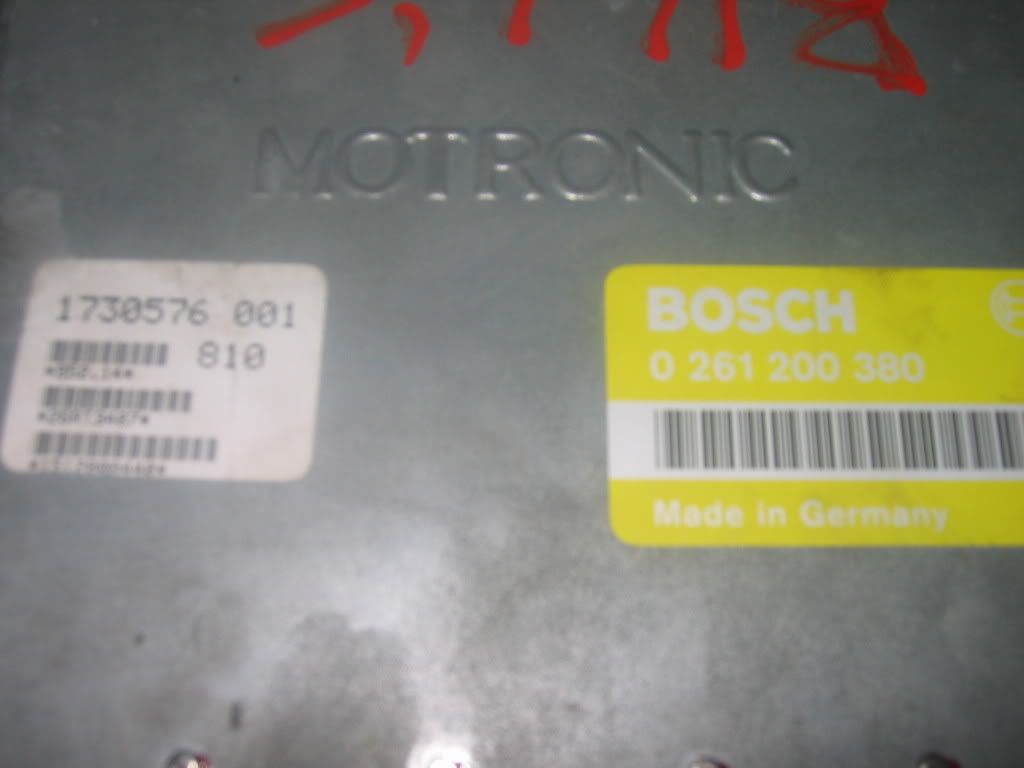

    I ordered this mama jamma off bimmerforums, the guy said it was a "173 ecu"
    Nope. It's a 380 ECU (look at the last 3 digits of the BOSCH number on the yellow sticker), BUT, it should work where a 173 ECU works. Not sure if aftermarket chips are interchangeable though....
    173 ECU's have grey stickers, 153 ECU's have green stickers, FWIW.

      the ecu i have now is a 153. I thought getting a 173 would be an upgrade so i ordered a tmc chip for the 173 too.
      What should i do in this case? Force the guy to take it back and refund my money/shipping or just resell it?

        I would:
        1- notify the seller that the ECU they sold you is NOT a 173, see what they say.
        2- ask the people you bought the chip from if it will work in a 380 ECU.
        3- this will depend on the answers to #1 and 2- but if the chip will work in the 380 ECU, then you are good to go. If not, then I would tell the seller that it's the wrong ECU and you can't use it and would like a refund.

          Anyone know if a Jimc/TMC chip for a 173 would work with a 380 ecu?

            Call or email the place you bought it from if you REALLY want to know for sure.

              the chip should work in that ecu. Just give it a try; it wont hurt anything.
