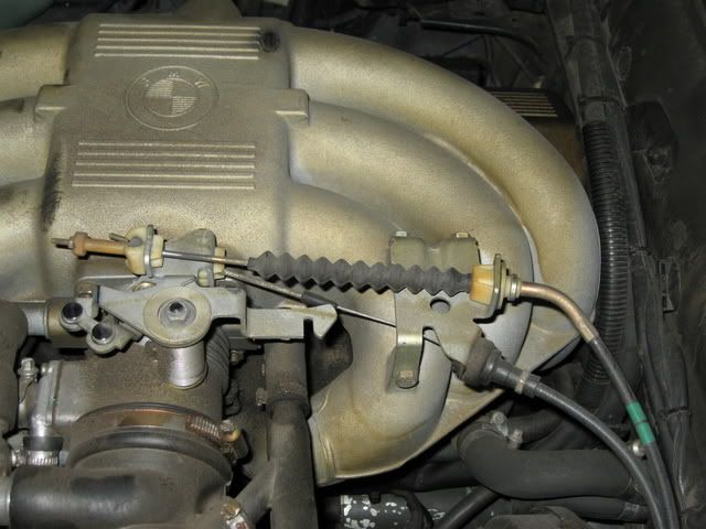

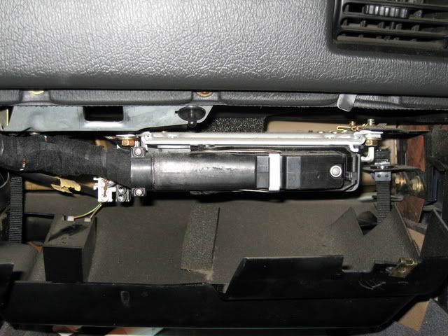

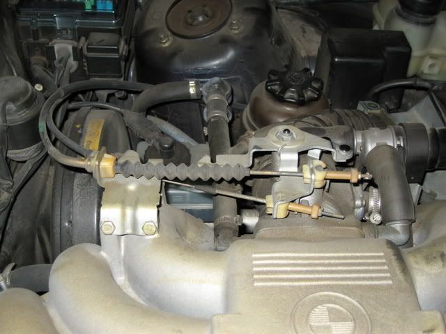

    Ok, so I tried using my cruise control today and discovered that it isn't working (just bought the car last week). I searched the threads and found some stuff and starting looking in my car.
    Call me crazy but isn't the CC control unit supposed to be in there above the other control module?
    Anything seem out of place/wrong here?
    Forgive the noobie please....
    actually, i think is above the drivers side under the dash. i may be wrong though

      No, There is supposed to be the CC module above the glovebox.
      I forgot exactly where in there it was, so I can't say for sure if anything is wrong in there.
      Hope this helps.
      -Erik

          There is usually a box above the ECU. Mine however had moved over to behind the radio. I also have had one of the cables that was broken in the sleeve. Make sure you can pull it manually from the CC unit by the airbox so that it moves the TB.
            my wifes e28's cruise never worked. i started investigating, and it didnt have a cruise control computer! put one and and works perfect
