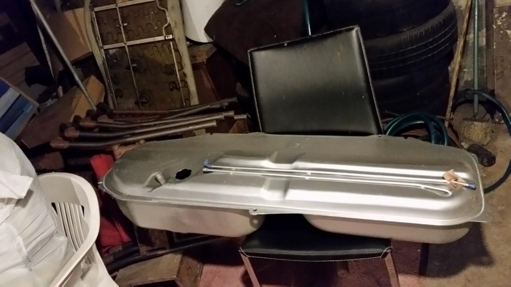

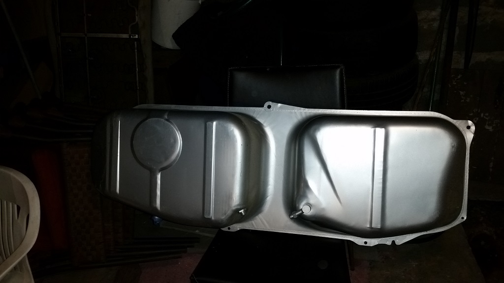

            I have an aftermarket tank for a 91 318is i bought a long time ago and never installed. I'll take some pics later if that helps

                  91 318is gas tank
