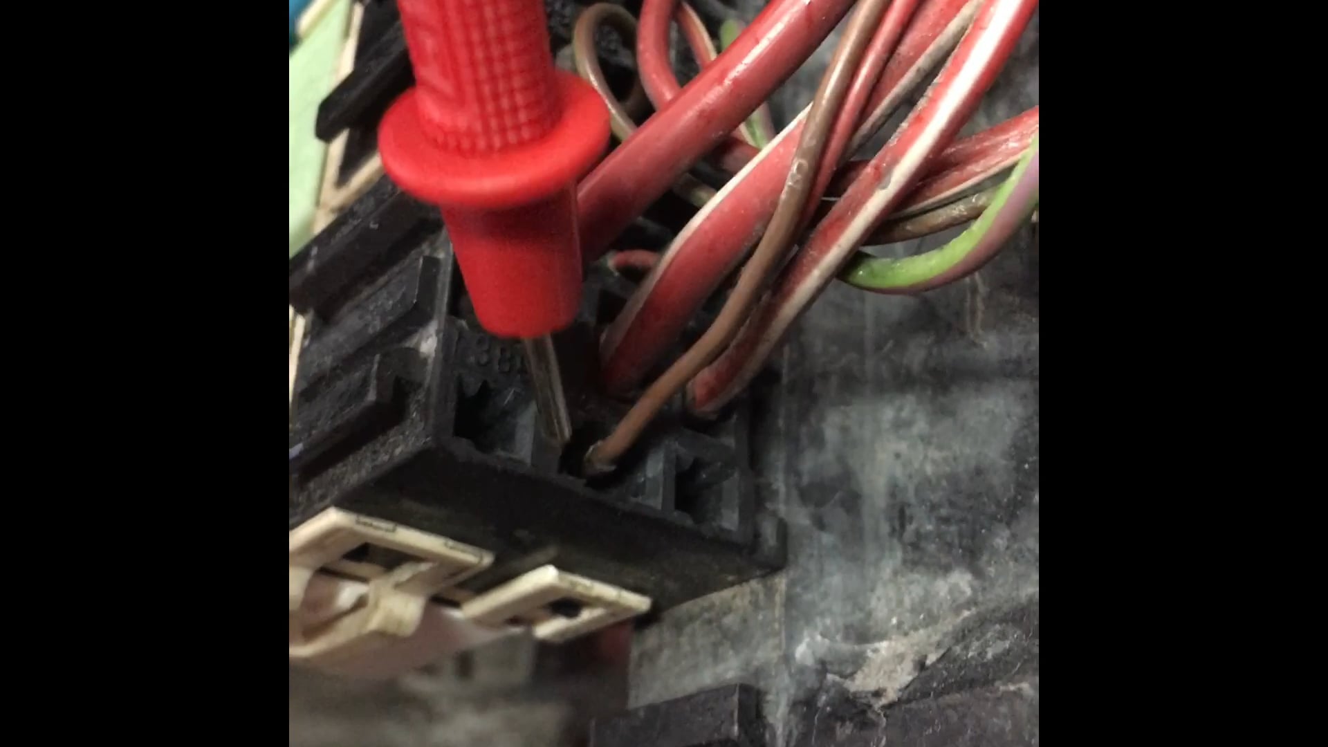

          #49
          is this right for the ground on the main relay? ignition is off completely
          This is "Untitled" by Jonathan Hauri on Vimeo, the home for high quality videos and the people who love them.
