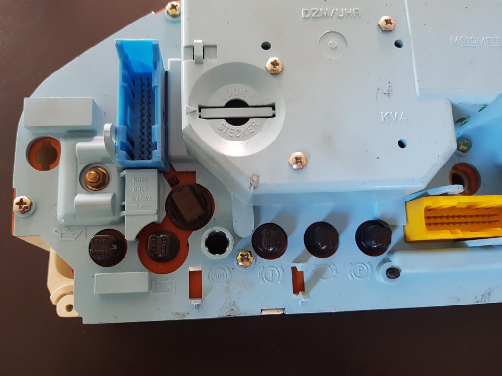

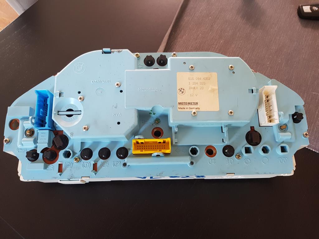

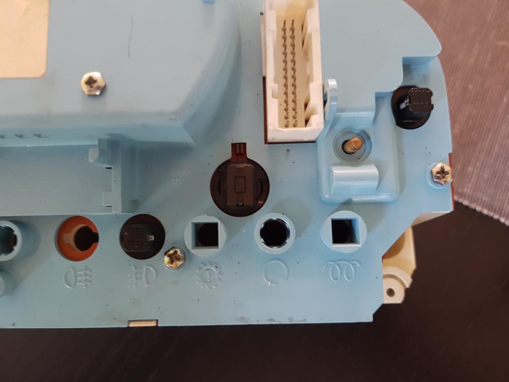

            I removed the cluster and noticed the nut is missing from the back of the fuel level sensor. Could this be related?
            pics attached
            1991 318is
            F31 328d
            e70 x5d - DPF, DEF, SCR delete.
            135i cab
            F80 M3
            • muppetman342
              • Oct 2017
              • 70
              pics attached
              That definitely isn't helping. Those are the grounds for those gauges, I had the same thing and replacing that nut solved my problems.
