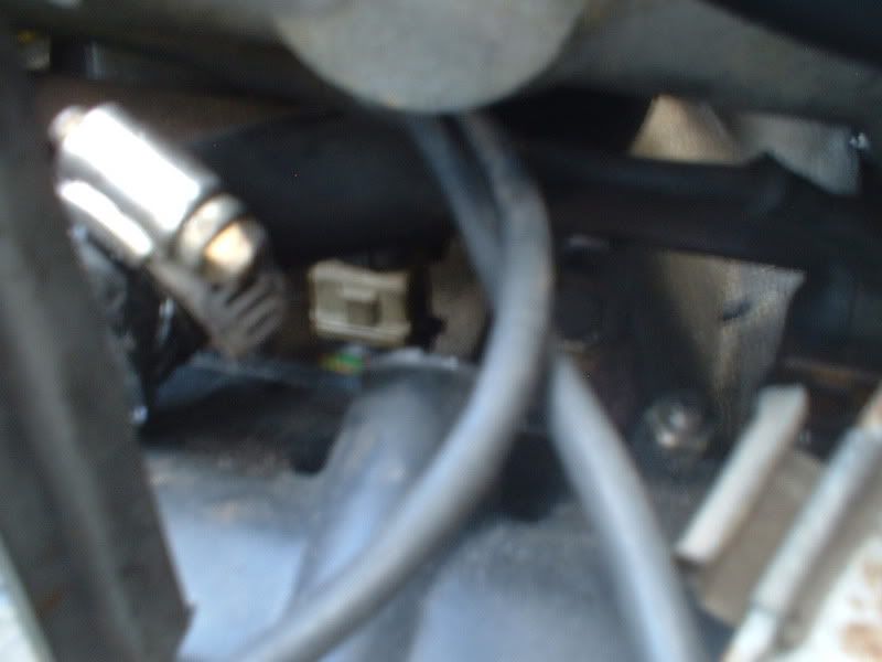

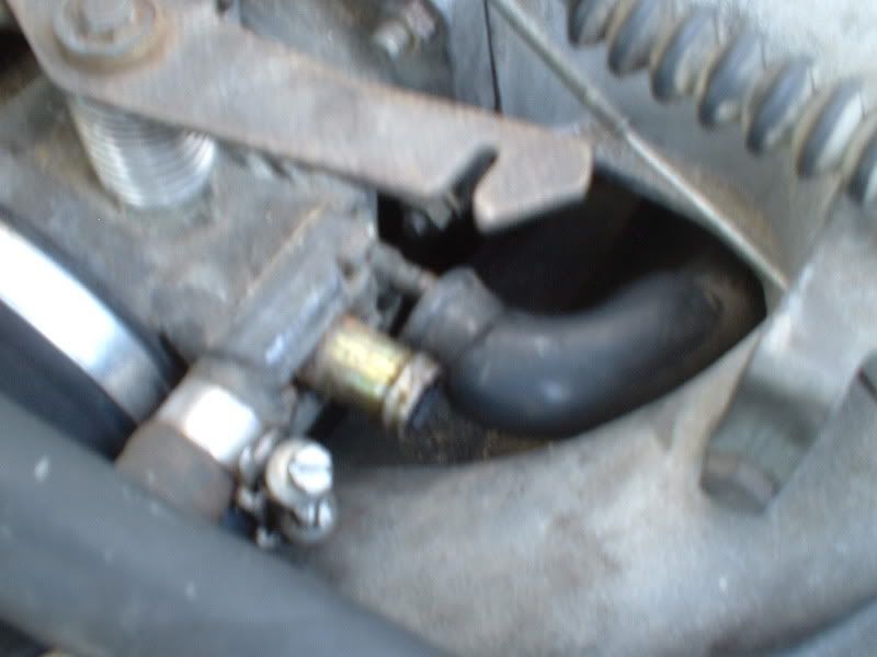

        Alright check this out i disconnected these to lines... NOW THE CAR STARTS EVERYTIME AND IDLES PERFECTLY WTF?!?!
        The top one is on the TB there were to hoses on there. i took 2 of them off the second pic is on the valve cover that hose connects to the TB i take these off and the car runs like jesus? wtf?

          Could the breather hose for the valve cover be clogged like on the throttle body cause theres alot of shit in there and without the breather hose on the car fires right up.
          • silversleeper
            • Mar 2005
            • 2032
            i think you found it. although i never would've though that one little thing could cause the car to fail to startup. and how much gunk is in it? looks like its seeping out the tb. your pictures suck.

              hahahha i know camera is a old digi! But yeah i think i found the problem but i still think i have a vacuum leak where the brakes have somehting to do with it idk. Well this is a glorious day for me :D
