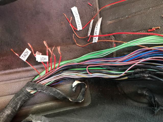

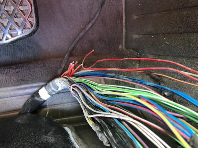

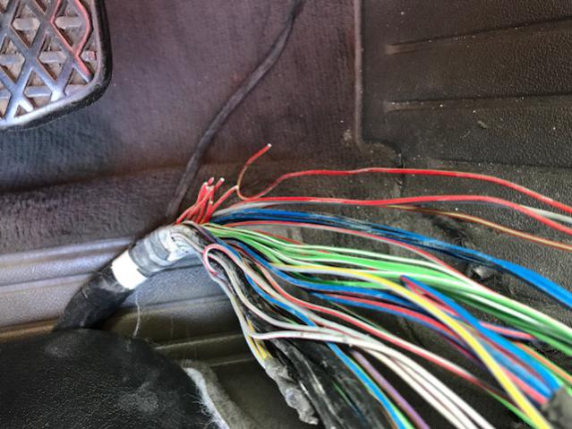

            No tach or OBC
            I had an intermittent tach but the OBC worked fine...figured it must be the SI batteries (after searching forums), removed the cluster adn replaced the nearly dead batteries...now no tach or OBC.
            Looking at the wiring diagrams http://www.armchair.mb.ca/~dave/BMW/e30/e30_88.pdf
            I can see S319 being a common splice point for the tach and OBC, also no trunk light, dome lights etc.
            S319 is found near the pedals under the speaker (88 325 Is)
            Surprised to find all the red/green wires are cut...looked factory.
            Spliced it all together and everything works!
