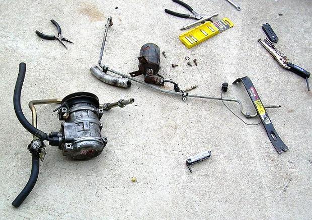

    Anyways, I'll post some pics of what I accomplished today with the A/C removal (removed both lines, receiver/dryer, and compressor and bracket). Going to remove the condenser once I have the motivation to take the front bumper off.

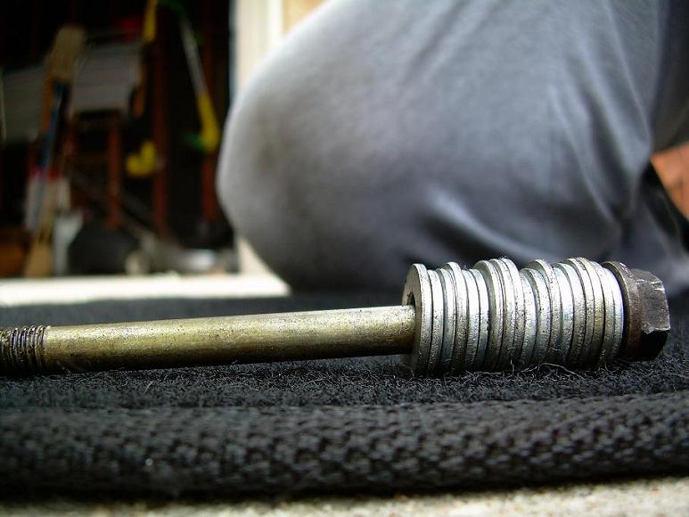

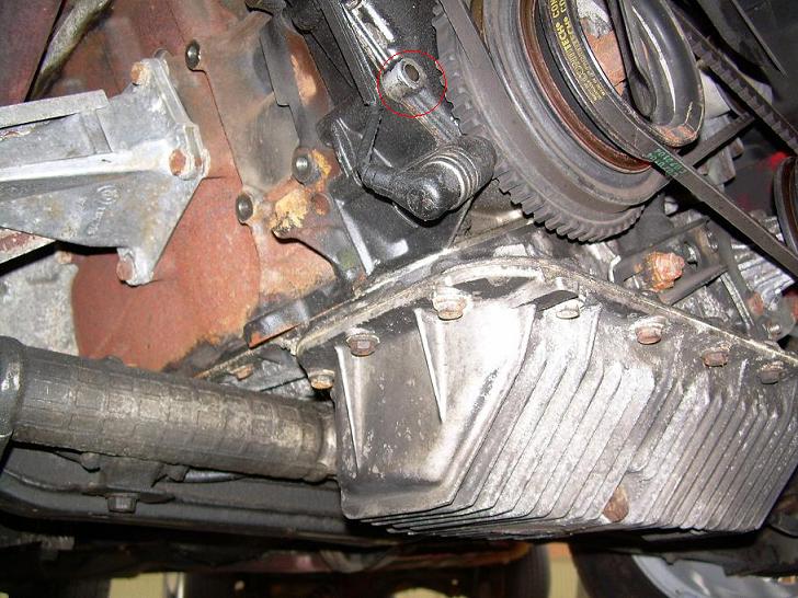

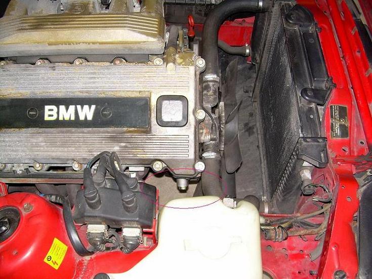

    My questions is in taking off the Compressor bracket, should I reinstall the 5 bolts that held it to the block? I did reinstall the very long bolt and made it tight to the block by adding about 25 small washers to it, there is a pic below, tell me what you guys think. In the other pics, you'll also see the bare 5 holes, and my main concern is in leaving them open like that. Is it easy to buy up 5 new shorter bolts that perfectly thread into those holes on the block?

    pic of removed various lines, rusted out receiver/dryer, and compressor

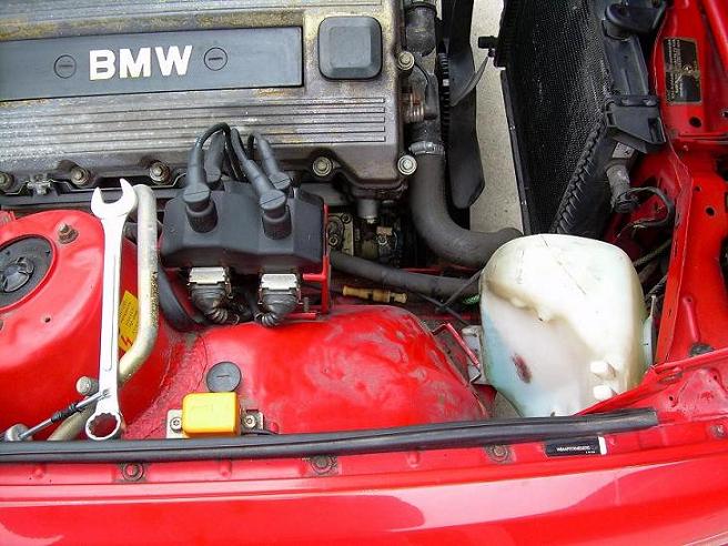

      side pic before compressor was removed

        side pic after compressor and lines were removed, new empty area circled in red.

          bolt with washers.

            empty holes that I'm questioning if they need to have bolts in them? red circled one is now where the bolt with washers is.

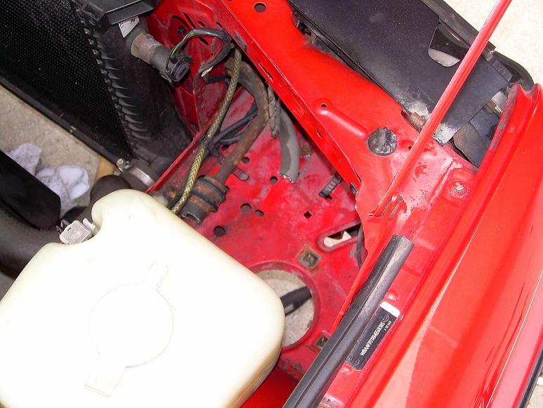

              ghetto cut lines that now are only attached to the condenser.

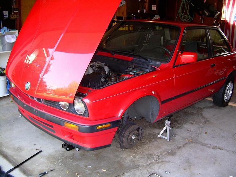

                pic of car in the process of front wheel removal and cleaning yesterday, as well as lower splash guard removal, fog coers, fan shroud, headlight backing covers, all for cleaning, and some to keep off.

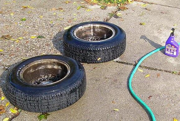

                  a wheel before pic.

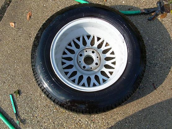

                    and a after pic. :)

                      Nice work! Car looks good as well. I would find some bolts that go into the holes. They are cheap and will give it a cleaner look. Also, water could get it the holes and freeze, cracking the block:down:

                        Yeah, that makes sense. I'm just wondering what you guys have done on your cars if the A/C comprssor bracket was removed? I could always just put the stock bolts back in for now, even though they are too long. Hmm?

                              I also put the A/C compressor bracket back in. I removed the pulley, simple greened the crud off it, and high temp painted it in black. So at least it looks better than it did.
                              Even with all the 6 bolts back in with extra washers, it couldn't mimmick the force the bracket put on the seal, so it was very minorly leaking. The small leak is now gone since I put the bracket back on. Good thing it only weighs 3 or 4 lbs. The majority of the weight was in the compressor, condenser, electirc fan, and a bit in the receiver/dryer and various lines and fittings.
