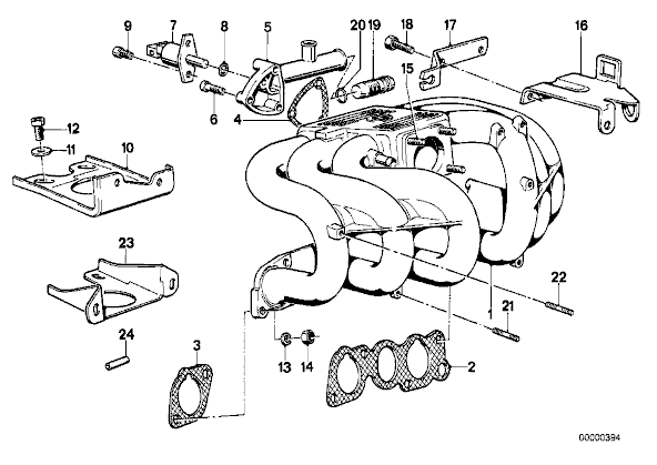

                According to realoem the cold start valve was not installed on Euro M20s. p/n #7

                    L-jetronic engines don'y have electrical ICV.
                    On that earlier posted realoem picture look at the part #5, it's the idle adjuster, track the rubber hose from it and you'll find the rheostatic cold idle valve below the intake manifold.
                    The looping idle is propably because of the ICV is stuck open, revs will raise up to 1000 rpm and then the coastal cutoff is shutting injector feed, until idle drops below ~900 and cycle starts over again.
                    EDIT: http://www.realoem.com/bmw/showparts...34&hg=13&fg=15
                    Part # 11ADDITIONAL AIR SLIDE VALVE
                    Is the part I ment.
                    The rheostatic ICV is not serviceable and cleaning usually doesn't help.
                    If you cannot get new rheostatic ICV, plug hose from ICV to manifold and adjust idle speed correct when engine is warm. Doing that will disable cold start idle raising, so car will not idle properly(if at all) when cold.
                    EDIT2: Euro spec m20b25 allways have Motronic, M20b23 allways have l-jetronic and m20b20 have l-jet untill M.Y. -88 after that they have motronic.
