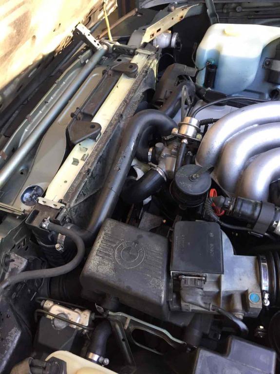

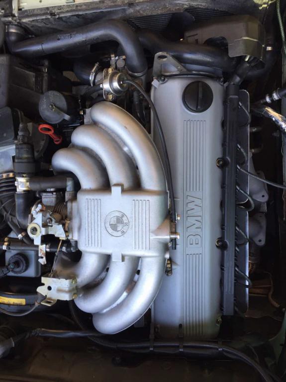

    I cleaned, clear coated, powdercoated the heck out of my engine and among all that I can not figure out how to make cosmolined black plastic to look good. Any tips?

    Go to Home Depot buy some paint thinner and BOILED linen seed oil. Has to be boiled.
    Apply paint thinner first than linen oil. Stand back in amazement as plastic becomes brand new, test on air filter housing you’ll see.
    Be careful with this crap don’t get it on your paint, just rub very light amounts.
    I did this as a way to clean my bay, not to remove cosmoline. But it might work for your troubles.

        I've used Eastwood engine black on the metal pieces and their black plastic paint on exterior black trim. Haven't tried the plastic paint under the hood.

          Thanks I will be giving the linseed method a shot.
