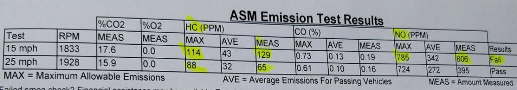

Hi I have a 1988 325i with stock motor and everything. I changed the oil and spark plugs took it to smog. I passed emissions but failed visual because the check engine light didn't illuminate when the key was in the on position (didn't even notice). Luckily, that was just a ground issue and I got it fixed in a few weeks. Went back for smog and now I failed emissions!!! HC and NO are high at 15MPH, I don't know what could have caused that, the results attached. Any help on what it could be? Only thing I've noticed is the temp gauge generally runs on the cooler side not sure if that's related.

Can it be anything technical? Like looking at the other smog posts they suggest things like o2 sensor and stuff based on the results? Like the car is running lean or rich or whatever?Comment

You have a leak in a vacuum line that is causing the high HC count. Just went through that on my car, it only takes a tiny crack in the line to affect HC.Hi I have a 1988 325i with stock motor and everything. I changed the oil and spark plugs took it to smog. I passed emissions but failed visual because the check engine light didn't illuminate when the key was in the on position (didn't even notice). Luckily, that was just a ground issue and I got it fixed in a few weeks. Went back for smog and now I failed emissions!!! HC and NO are high at 15MPH, I don't know what could have caused that, the results attached. Any help on what it could be? Only thing I've noticed is the temp gauge generally runs on the cooler side not sure if that's related.

I would have to smoke the system to find the leak right? Could that be causing the car to run cold as well? Cheers fellow san dieganYou have a leak in a vacuum line that is causing the high HC count. Just went through that on my car, it only takes a tiny crack in the line to affect HC.

Smoke is how I found the tiny leaks in the car I have been working on. Leaky O ring on the injector... I would think your thermostat would have more to do with the running cold issue.
