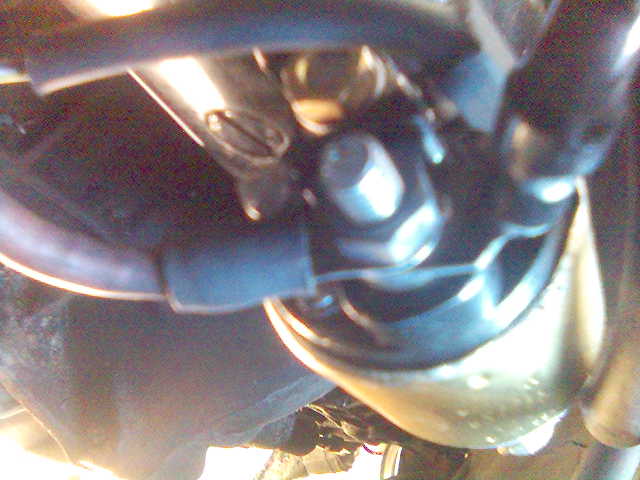

    I had just redone my head (292 cams etc etc), put everything back together EXACTLY the way i took it apart, nvr touched any of the ground wires and now my car will not start. Batter is fully charged and is well (took to advance autos); suspected starter: took to advance, they said it was bad, got a new one, put it on and still no start. Does not turn over but you can hear the relays click. Ive read some other posts about the ground wires but like i said i nvr touched them...but could they still be bad? Also i dont know if im wireing it up right...theres three wires. 1 reddish, one black, and one green black (very small) i know the green and black hooks up to the lil knotch thingy. I know the black wire goes to the positive terminal on the starter bc it is directing connected to the batter positive terminal. The reddish wire...no clue. i think it also hooks up to the positve terminal.
    All be at work till 1 am but ill hitting this up first thing in the morn. Help is greatly appreciated...i need this up and runnging! (the 325i hates being the DD )
    i attached a pic of my starter with the wires...you can see the wire to the left is the reddish (maybe brown??) wire, the the right is black, and to the top that lil square wire is the green/black wire

        Take your negative cable of your jumper set, and clamp it on the oil pan drain plug, clamp the other negative onto a strut tower or other well grounded location and try and turn it over. This'll let you know if it's the ground or not.
        I can't really see the picture too well, it's pretty fuzzy.

                    It WOKRS! i got the starter to turn over! My old starter had one knotch to hook up the ignition wire. The new starter has two. On in the same spot as the old starter and one below. I hooked up to the one below and it turned over.
