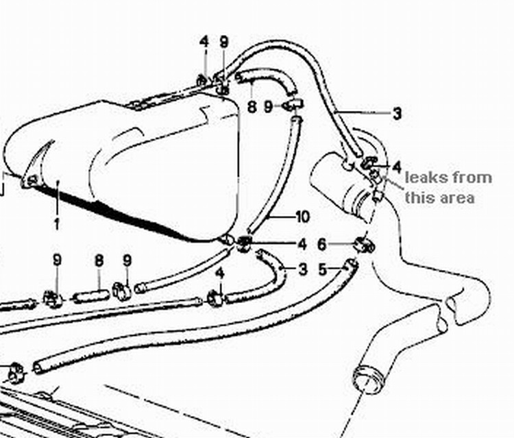

          Leaks are common here. This was the source of mine.

              wow nasty, hope mine does not look like that.

                  There is a steel "Y" pipe that is rusted out above the wheel well behind the overfill container. When you fill the tank the overfill is supposed to go into the small plastic tank and be sent to the gas tank but since the "Y" connector is rusted out it ends up on the ground behind your wheel. My e30 had this problem until I replaced the "Y" connector.

                      it could be ther rubber hose that connects the fuel filler with the top of the fuel tank. check that out first, then look for more serious problems..
                          yeah mine was doing this, leaking from rite where the hard lines on the tank end, and the rubber lines connect. its a PITA to change, but lucky for me just changing the rubber line that goes to the filter got rid of the leak.
