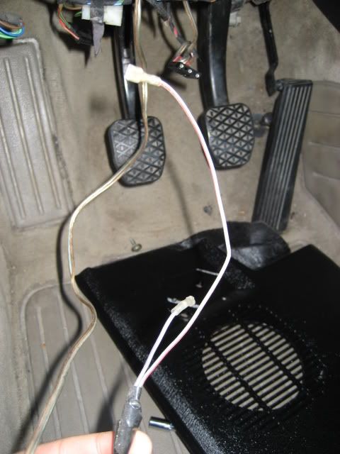

    So, I was trying to find out why my central locking isn't working today, so I took off the knee bolster and driver side kick panel to check things out. I found a couple wires and connectors not attached to anything.
    two wires in my hand, and also the white connector above my thumb coming out of the speaker well
    and these two black ones, also the white connector above my thumb coming from under the knee bolster
    and these two, coming under the knee bolster
    If anyone could tell me where these connect to I'd really appreciate it.
    91 318is
    i think the white ones are for speakers...
      speaker wires. door chime wires. aftermarket speaker wires.
      In order of the 3 pics.
      None have anything to do with your locking system.
      the relay pack that the bottom of the speaker hole is what you are looking for. One of the 2 controls the locks, the other controls the dome light.
