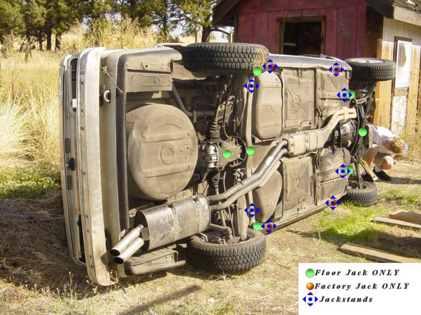

    Where are the best places to jack up the e30 and the best places for the jack stands (when all four corners are up)? I remeber seeing a website about this topic but I dont recall where.

      On e30's there is nothing wrong with jacking on the diff. You arent going to harm anything.
      Here is what I would recommend.

        Thanks to both. Jordan, thanks for the pic (sure beats the hell out of reading). :D

                Most useful picture I've ever found
