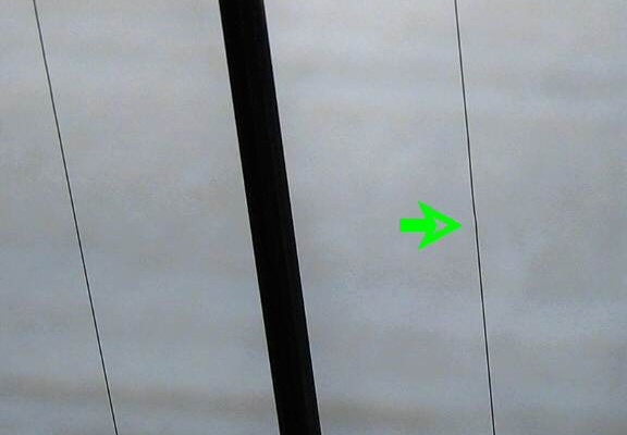

                              i was searching for troubleshooting info on this topic - my guage would never read anything above 1/3 tank.
                              checked the sensor that sits with the pump, everything ok.
                              by having searched the site, i came to find that theres a second sensor. well damn.
                              pulled it appart and it was stuck. it somehow gained a knick in the wire (it was sitting for almost a year w/o fuel level change). Picture taken at wrong angle to show hump.
                              but when fuel is forced to one side or another, the two sensors normalize the guage reading.
