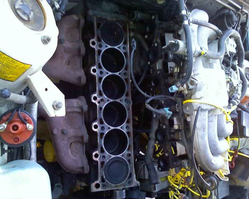

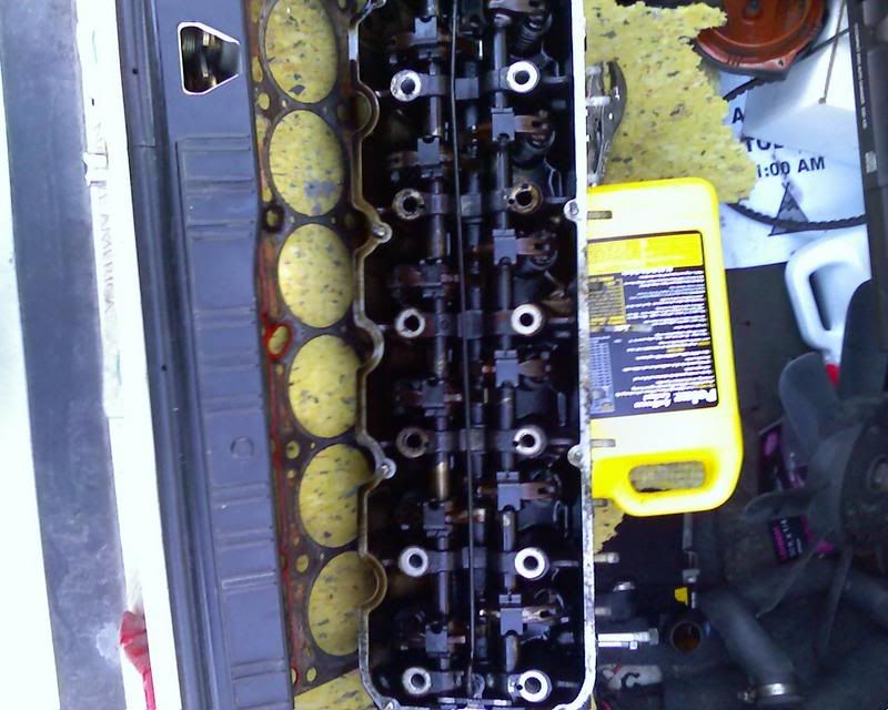

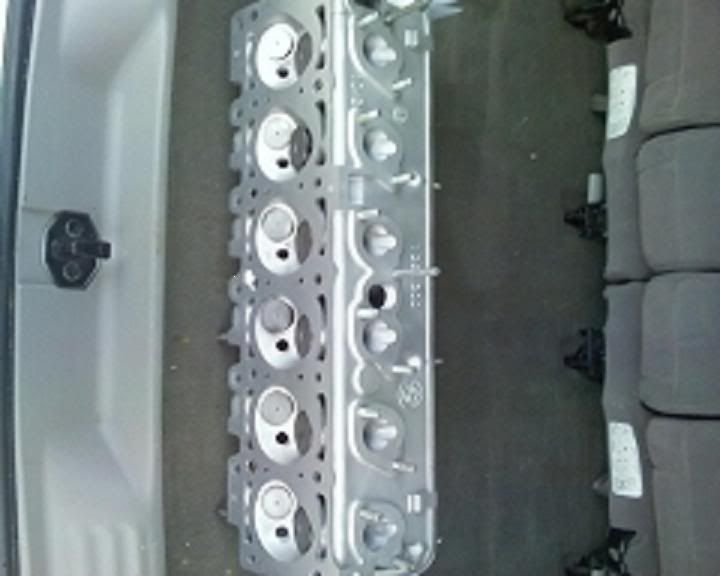

                REplace all the seals on it from the heater core flange seal on the back and may as well do the injector seals too. Don't forget about the seals on the oil drain back tube and make sure you put the spring and tube on before you set the intake on, or it will never go on. On my i I did it like this but on my eta I had neglected to put the lower seal in and had started bolting the intake down, luckily my head bolts were only finger tight so I took them out and tilted it up enought to get the tube in and out.
                Here are some pics of my eta head job.
                pre machine shop
                Before cleaning
                Close up of water jacket after pull.
