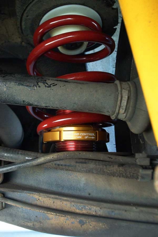

Originally posted by modifiede30you don't HAVE to weld them....
It's not risky at all, but you lose a lot (I'd say at least an inch) of adjustment (if you don't cut off the old perch). Plus you lose a little unsprung weight your strut will be all pretty-like. As for just sitting it (if you do cut off the perch), I would never do it for peace of mind (it's a halfass job), but I'd be semi-comfortable with it. The collar is nice tight fit on the strut, plus you never weld it to the strut anyway - just the GC perch.
mine's not welded and i've had no problems, i've held off because i'm going to get konis and chop part of the strut out. Honestly, I don't see the downside to not welding the perches, though I could weld them myself... they're always under tension so they couldn't lift and come back down hard. That being said mine will be welded down with konis

I don't understand the question you're asking exactly. The e30m3 rear vs non e30m3 rear for a GC install is the same. The threaded collar just sits on the trailing arm. It can be a PITA to get it out though.
If you have access to you red car, simply jack up the pass. side safely and take a look at it if the stated message above doesn't answer your question.
You will have your answer in less than 10 mins.
Good luck
Edit: Attached a pic. HTH
yeah, i found the answer (just sits on a "nub"). but if I checked the eta, or even had time for that today, i wouldn't be sure if the GC sleeve just sat on it or what.
the red one came with the GC's, so I wasn't sure whether they plopped on or what for sure. and was looking for the installation instructions, etc. now i know for sure, thanks
