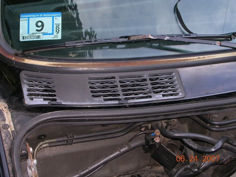

    So I have a water leak on the pass. side of my car, at the top of where your left foot would be. Here are the pics.
    This is where the water comes in. In through these two little grate things. The water comes in 99% from the driver's side one, 1% on the pass. side one.

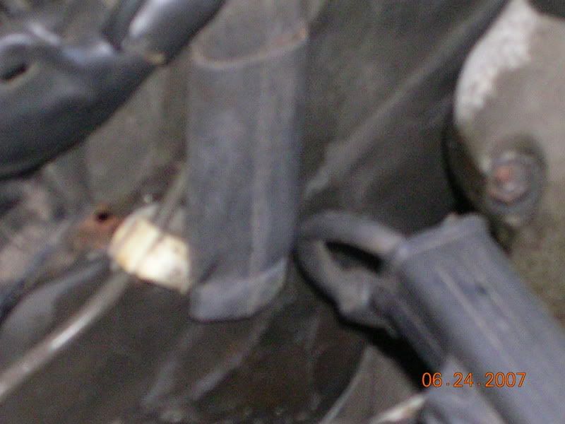

    This is where the water should come out. It does come out here, but also leaks in the car. The water will come out on the driver's side if the angle of the car is right. The water seems to travel indide the car along the tube to the exit point in the second picture. This tube inside the car is what is leaking. Can anyone tell me where the tube runs inside the car, if this is the case. I think that I am looking at a dash removal here.
    Any help would be great.
    Thanks.

    take that plastic tube off on the 2nd pic and clean it, usually get all kinds of crap in there and blocks the water from draining out, then just put it back in.
    • FredK
      • 14759
      Sunroof drains? Blow em out with compressed air.
      Next, check the heater core bulkhead foam seal. This goes bad over time.

        I cleaned that part like the firts reply said and it helped. I think that this line goes through behind the blower motor cover. I will take a look there.
