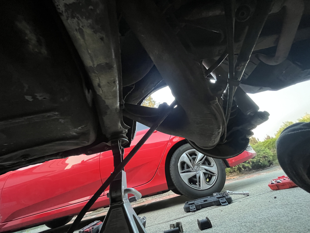

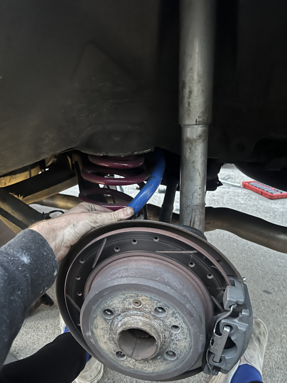

                  Had trouble finding this information so I figured I would post it here. Removal of the E30 rear swaybar, its a lot of back and forth to find the right spot for it to move. If you pull it through the passenger side rear trailing arm, there is enough room to get it out, as shown in the pics. To put a new swaybar in, I started from the drivers side and pushed it between my spring and my strut, and then wiggling it around until it move where you want it to be. Be sure you don’t put it in upside down!
