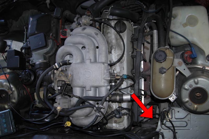

          Can you please describe where it is to this picture. Sorry, I don't know much about mechanics.
            Look in the bottom right hand corner of the picture, where the battery was in some models, there should be a terminal on the firewall. It is like a square with 5 or 6 wires connected to it. In the late models there was a rubber neck that went into the cabin. That is where it should be. Though you might have to peak under the wire cover if you have one
            • Jscotty
              • Jan 2007
              • 2285
              This is almost like "Show us on the doll where the bad man touched you!"
              Ok.. seriously- if you look at the arrow pointing to the boot, either that's it or there is a rubber boot similar to that in the battery tray. In case you are aware, the battery tray under the hood is that grey patch in the lower right corner as 91 tradgedy indicated.
