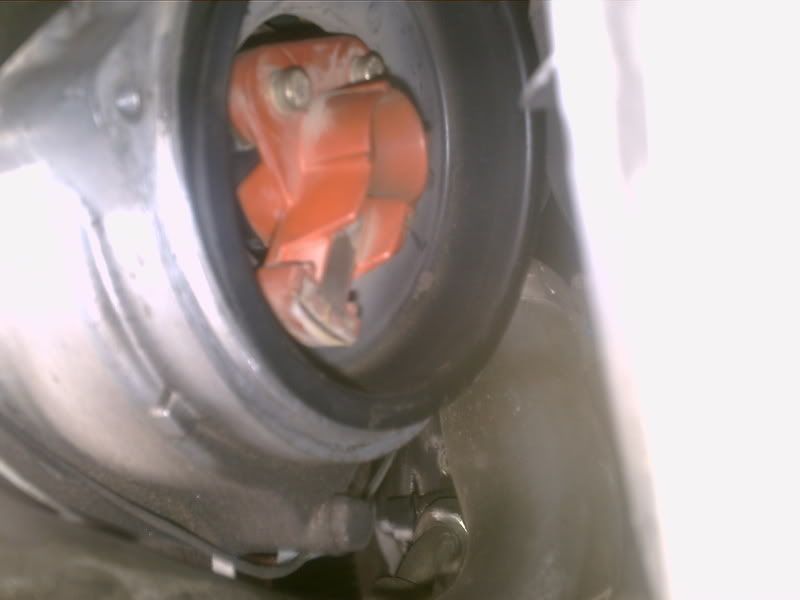

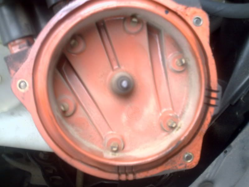

                  check out my distributor:
                  comments?

                    Your pictures aren't good enough to tell, but it appears to look ok.
                    You're looking for corrosion or badly worn spots on any of the metal contacts both on the cap and rotor. But really, they aren't bad to replace anyway.

                      yeah i took those pics quick but whats up with all the dust in there? and the cap terminals feel eroded when you run your finger on the terminals you can feel that they are rough and you can see that the terminals look a little charred or black. the rotor tip looks burnt.
                      i really need to look into a big tune up of key parts. today it almost didnt start when i went to the store.
