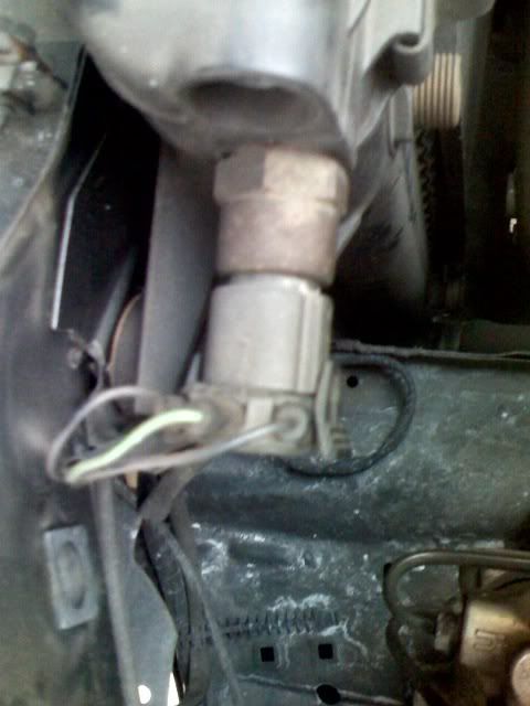

    Check the temp sender on the radiator (3 wire connector). Sometimes those connector housings break and the wires short temporarily.
      If that's what you're talking about all the wires seem to be in good working order

        Yes, thats it and it looks ok from the picture.

                  As for that sensor on the Radiator.. are you sure that's not just a fan switch? My connector there is complete shit.
                    Yeah, temp switch. The senders for the ecu and the guage are on the thermostat housing. Mine was crap too, I held it together with some CA glue, and dipped the assembly in a can of some liquid tool handle insulating junk. Its holding up well and looks good.
