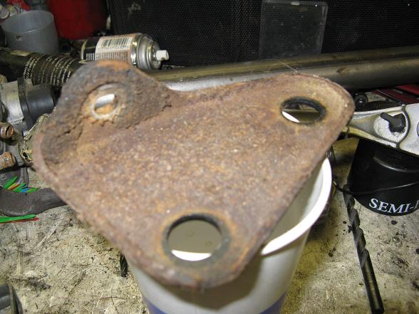

                        I'm trying this with a bracket that has rust on it. I only used enuff vinegar to cover part of the bracket. The rest of the vineagr i will use on my french fries :p. I will post picture of it tomorrow after i see what it does from sitting in the stuff overnight. If this does work, sandblasting will be cheaper and faster still.

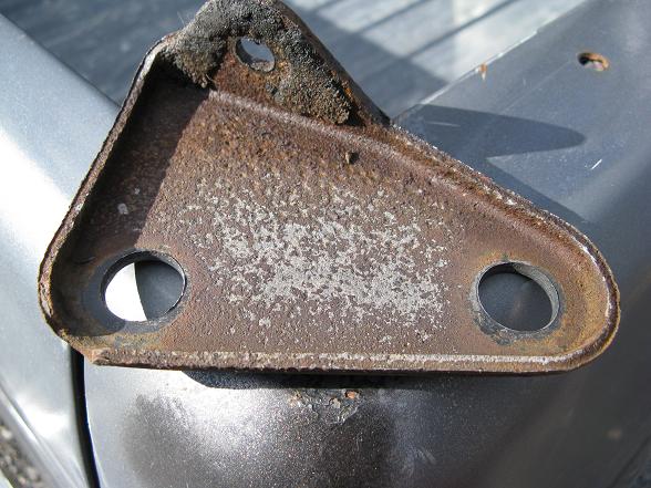

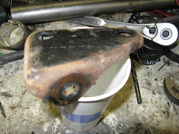

                            My findings:
                            I let it soak overnight and then some. I only let half it of soak (part with the two holes) And here's what i got after about 5-10min. of scrubing.

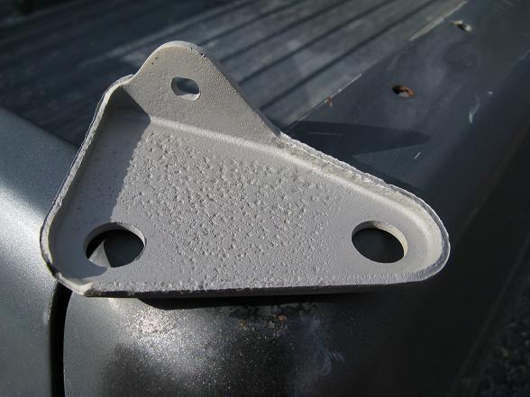

                            The same amount of time in the sand blaster,
