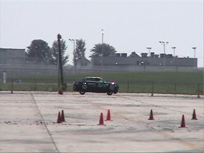

                        • Brew
                          • 3060
                          are you sure you really need that much rubber width??
                          Yeah, really dude. I saw that video of your car going up on two wheels. :shock: And you want more rubber??? You must be planning fender flares too, right?
                          '91 318is
                          • alex
                            • 2024
                            No, I'm not sure I need more rubber. No, I'm not planning fender flares, I like how this looks:
                            That partucular turn was very specific with just the right ingredients: high entry speed, decreasing radius, off camber. I know of another guy with E30 that went up on 2 in that turn at least twice.
                            • 808BMW
                              • 2910
                              That should be your sig pic :P
                              285's deserve fender flares. Hell, you could even mold outriggers onto the flares :P
