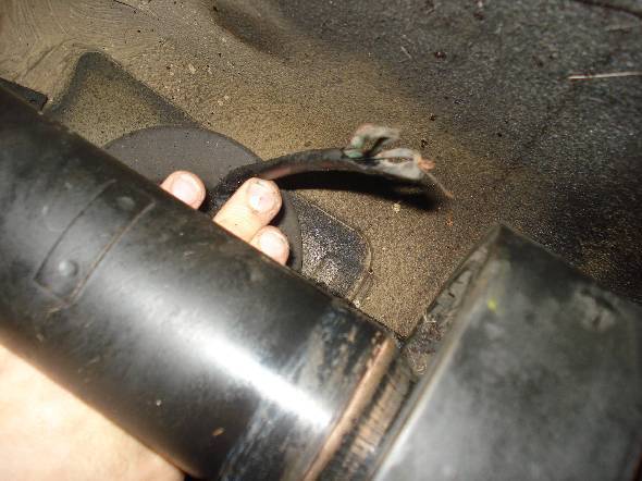

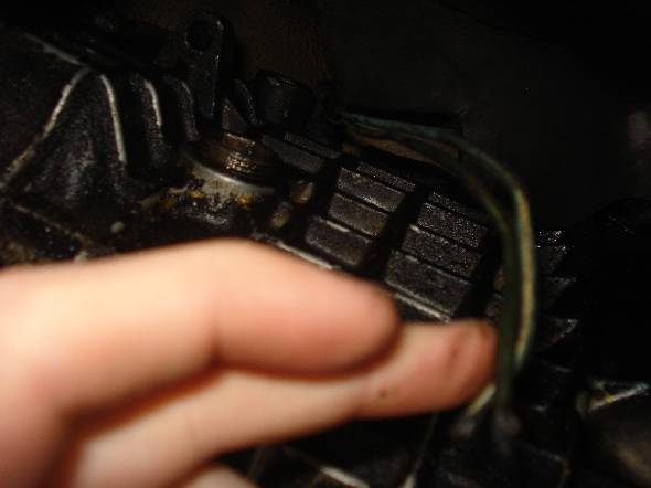

    I need some help identifying what these cut wires are and where they are supposed to lead.
    coming from the top of the transmission
    coming from the shifter
    I have a feeling these have part to do with my one fuse blowing ( SI board, heat, BACKUP LIGHTS).
    Thanks
    Jon

    Reverse light switch .

        Just add some friggin wire to it and connect the two end together and the circuit will be restored .

          Or I could just use the switch from my parts car. The wires are are all mangled from the drive shaft anyways.
          Thanks for the info.

            adding wires is easier... this is a very common thing as far as I can tell. Had to do it to both my e30's.
