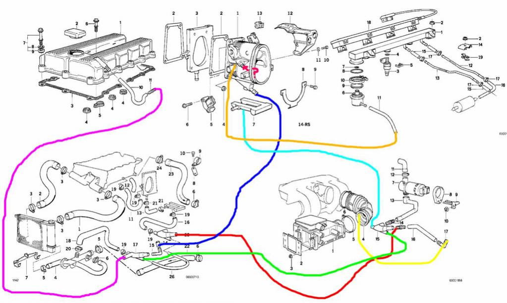

    after spending 400 quid on someone to fit a new headgasket and skimming, i get the car back yesterday and after driving it a couple of miles discover that it doesnt what to idle at all and has very lumpy running.
    i popped the bonnet to discover that the air hoses havent been plumbed up correctly and there's a pipe or some sort of junction missing.
    i have attached a link to a picture to the area in question. could someone please tell me what parts i am missing or send a picture of what it should look like. and if possible part numbers?
    http://www.flickr.com/photos/28132917@N07/2703482934/

    Well in the states the ICV sits between the back of the head and the firewall connected to some vacum lines. Run your car and pull the dipstick while running. If it gets worse chances are your problem ISN'T a vac leak. If it bogs down a bit, you have another issue. Maybe this photo can help.

      the pipe from the ICV should go right into the intake boot
