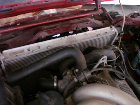

    I bought a 325i last month and I'm trying to fix it up. I noticed the radiator is just sitting lose! There are no bolts attaching it to the frame. I'm guessing the previous owner took something off, but I have no clue what it is. The radiator is pictured below. How is it normally held in?

    Looking through this thread, there is a bracket that goes over the radiator and bolts to the rad support.

      Thanks! Is there also a bracket on the bottom, or does it hang from the top bracket?

        If you look down the sides of the radiator, there are 2 little nubs sticking out. Those sit in 2 little plastic buckets attached to the core support, then the upper mount does the rest of the job.

          Thanks again! Does anyone know the years and models that will have the radiator bracket I need? The junkyard choices I have are:
          1981 320i
          1988 528e
          1985 318i
          1992 525i
          Any of those work?

            The bracket you need is on 1988~91 E30s with a 6 banger under the hood. I don't know about the 4 cylinders having the same mount or not.

                  Yep, two screws at the top and lining up the bottom bracket is all that is needed.
