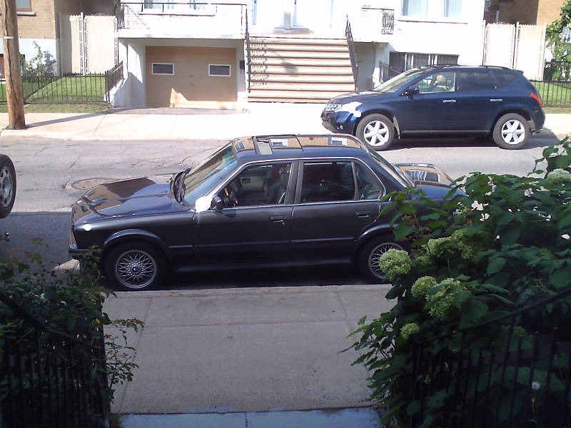

    so I'm going to look at an '89 325ix this weekend... hoping it's in good shape, if it is, it'll get scooped for the winter..
    My question is what should I be looking at on the 325ix...?
    Transfer case? What are things that are ix specific that should be checked to make sure I don't have to dump money in the near future? Other things non specific to ix's that should get checked?
    This is the photo..
    it is described as:
    "1989 325ix - automatic - equipped - sunroof - leather interior - aftermarket cd player - momo wood steering wheel - very good condition - 257 000 km (not miles) rebuilt motor and tranny 25 000 kms ago - bilstein suspension - 4 toyo winter tires, almost new - yada yada yada......
    Hopefully everything is as is stated in the description - I am somewhat skeptical.. he wants $3000.
    So, I am thinking that there are probably bilstein shocks....in the rear...or something, not "bilstein suspension"..etc...
    What else should I be looking at?
    Especially on the "rebuilt motor and tranny" ?
    Thanks a lot guys
    I want this car to be what he says it is!:bow:

      The paint appears to be really nice.
      I'd check to make sure it has been in any accidents. Make sure the windows and other parts have BMW markings on them. Look down the body lines for any inconsistencies. Do a carfax on it of course.

                    so i checked the car.. its a little rough aesthetically in some parts but seems pretty good overall. I'll get it fully checked over this coming saturday.
                    1 thing though, I suspect a leaky rack... I'll have to see. Are the steering rack ix specific?
