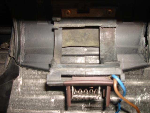

    I bought a 1990 325i and there was a pretty loud clicking noise when you turned on the blower motor. The seller said it was something rolling around in the fan assembly and I was dumb and believed him.
    When I took the blower motor out, I found that the plastic behind the fan was all busted up. A closer look at the car makes me think it has been in an accident, because there is a suspicious weld and bent metal in places along the firewall - all nicely repainted! I attached a picture of the back plastic piece. You can see a crack on the left side and places where the blower motor blades are rubbing.

    Do I have any option other than replacement of that back plastic piece that hold? It looks to me like you need to remove the entire dash and control panel to get at it.

    Try and fit a blower motor in there and spin it by hand, if it catches on the plastic you'll be better off replacing the blower box. It's not too complicated, I've done it twice (early and newer boxes aren't the same as I learned).
    You will need to pull the dash (also not rocket science), and you'll want to buy some new gaskets since you'll be there :)
    If you have any questions let me know and I'll try to help..

      The motor catches on the plastic is several places, so I think I need to replace the blower box.

      It looked like in the pictures they replaced the whole blower assembly, not just the plastic box. Is it easier to do that for some reason, or can I just do the box
      I did see the box for a 1989 325i at my local junk yard. Do you think that would work, or can you buy new?
        I replaced the whole thing, but you can replace just the blower box and transfer your blower motor/resistor and/or wiring harness onto it. it would just be easier to replace the whole thing and keep your spare blower motor ..
        The blower box is $$$ from the dealer, there is not reason why a used one won't work if it's not broken. The early ones had a different wiring harness, so get one from an 89 for your car
