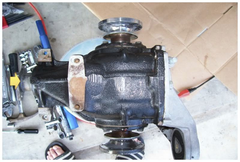

differential seal replacement (pic)
  • ///M42 sport
    • 3952
    How do I get the nut off the end where the arrow is pointing without it spinning? Is it easier to do w the diff on the car, attached to the half shafts?

    Don't fuck with the input seal noob .
    You'll never be able to torque the nut back down without crushing the pinion bearings .
    Just slap in the output shaft seals and pop in the flanges and be done with it .

      So your saying if my input shaft seal is leaking, I should just fuck it.

        I'd say fuck it or the othr option is to take it to a shop thst familiar with BMW diff rebuilds and have them change the seal for you .
        Or its also the perfect time to swap to a used big case LSD diff .

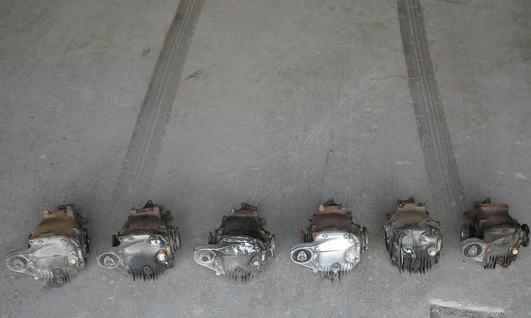

          why dont you send me one of the 20 spares you have lying around.

            What, one of these ?
            Sure you can have all of them for the title to your 318 . :p
