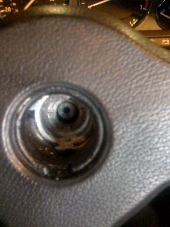

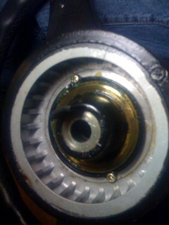

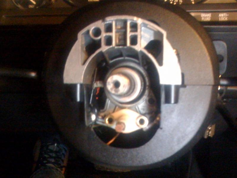

        here are some pics of the where the wheel will rest now. The shaft and back of steering wheel...
          From the looks of the last picture the wheel is not going on straight (maybe it is the angle of how the picture was taken). The fine splines can make it tough unless you have it perfectly straight to go on.
            yeah, it's a bad pic. when I hold and manipulate the wheel I can center it on the shaft but it still won't slide. I try moving it back and forth and side to side but still no luck..
            it's cold here today, maybe heat gun on the steering wheel and try and get it to expand a little?
              thanks for the help everyone. A few tries with the heat gun and the wheel slipped right on.
