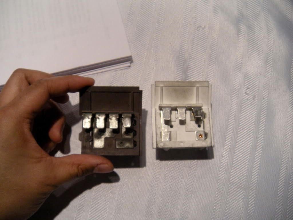

    Is this the correct resistor?
    Hi guys,

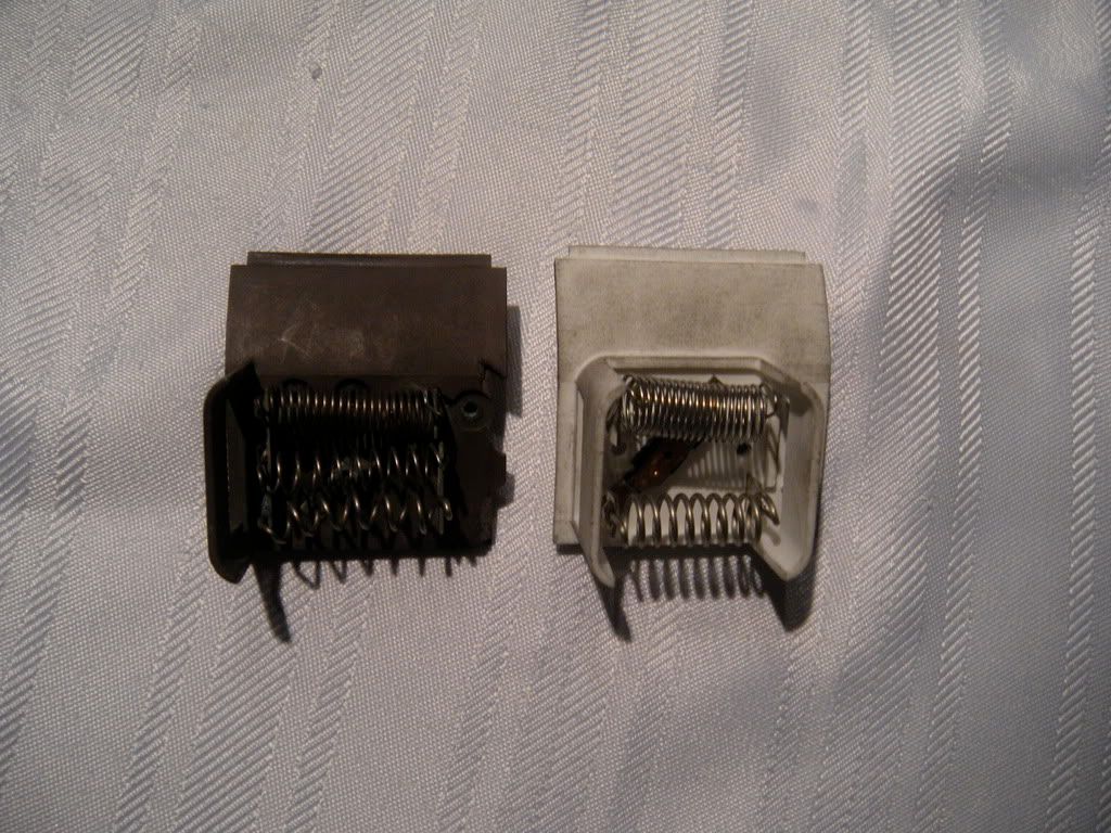

    I ordered a new resistor from bmw and gave them Part No. 64111370927. They told that the new number is 64111370927. I trust them and this what they sent me. (the white one is the new part) Will this still work? I tried putting the new part i but its just not fitting? The box also says Widerstand resistor BMW e30.
  • lordofthewaters
    • Oct 2005
    • 714
    Obviously not correct. Looks to me like one of the very early ones.
    Go here.http://www.pelicanparts.com/bmw/cata...pg3.htm#item22
    look for part number 64-11-1-468-521-M6 that should be what you had oem in your car.
