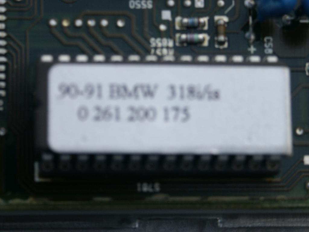

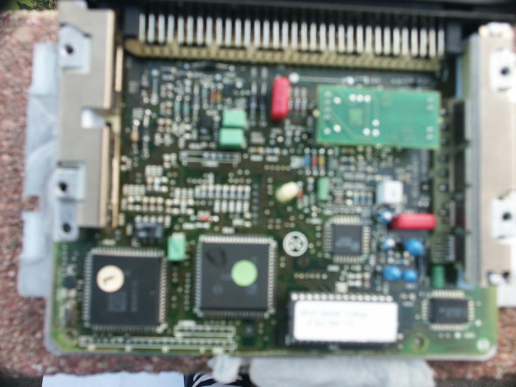

          And Finally i took pics of my chip. Please identify it stock? what brand if its aftermarket?

            Looks to be an ebay special
              Thanks for the quick response.
              The question now is: Hmmm should I get a Mark d!!!!!!!

                    The secret is in the fact that your gas gauge doesn't work since you changed your cluster. I'm willing to bet that you swapped in an early 325i cluster, which would explain the tach screwup and the gas gauge reading half. The gas gauge in my cabrio does the same thing since I swapped a late-model cluster into my early cabrio. The sending units are different between early and late, but the reserve sensor is the same. That's why the light still works when it should. Put your old cluster in and I'll bet all your issues go away. Also, buy a Mark D chip!

                      OK OK.... MArk D chip is coming ASAP... i was just hoping i would find one when i opened up my ecu.
