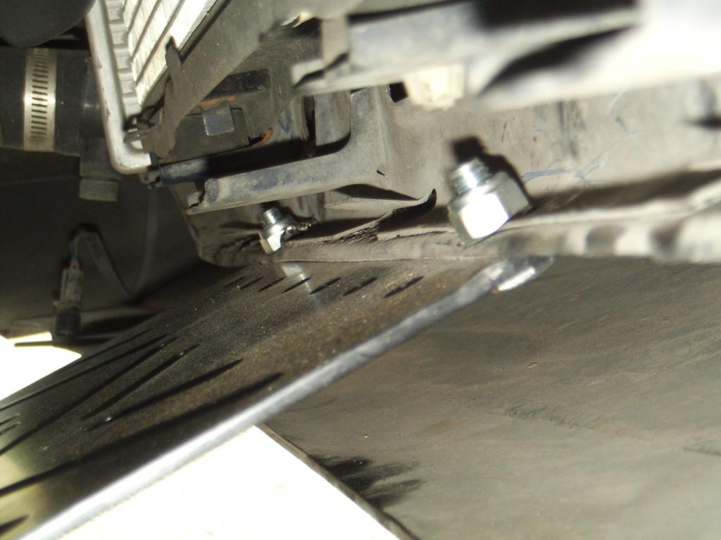

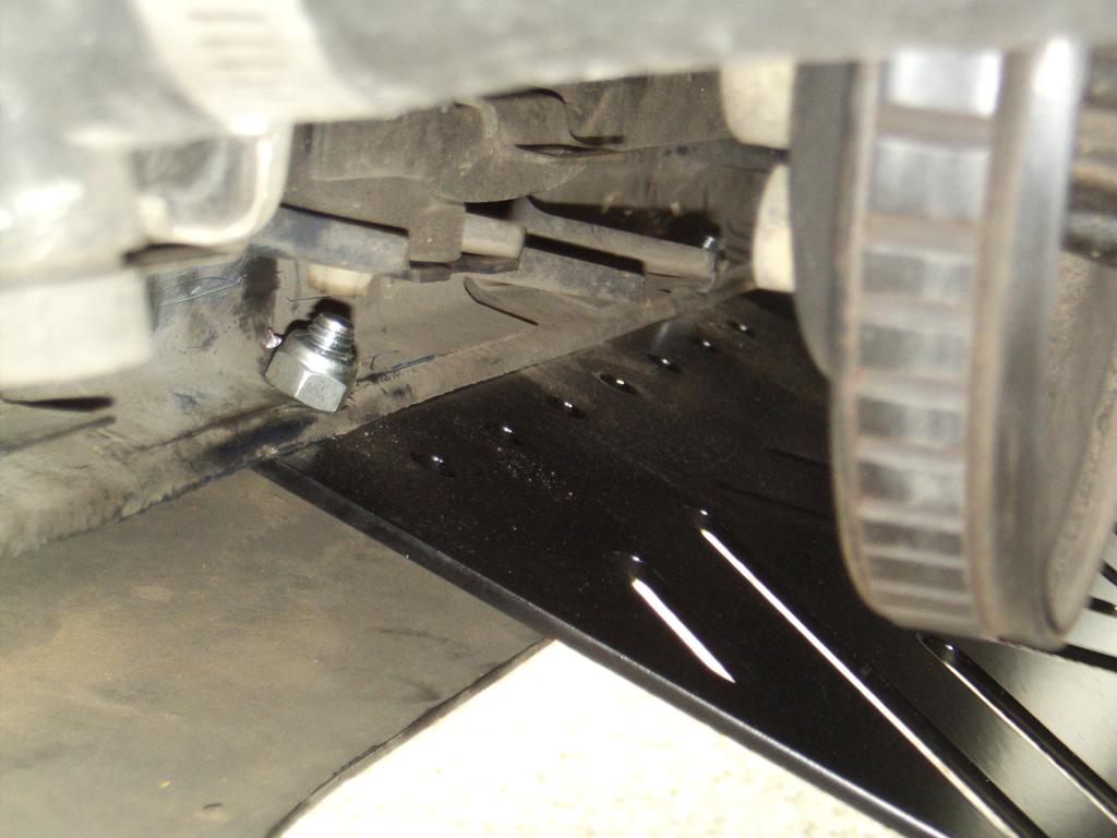

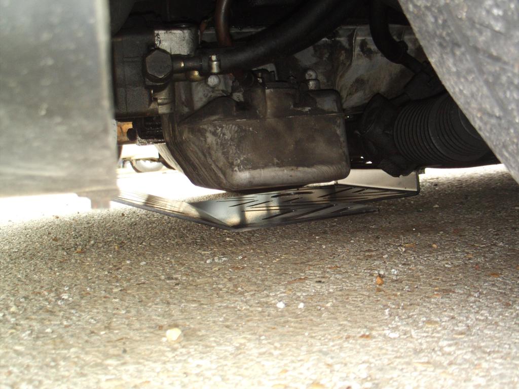

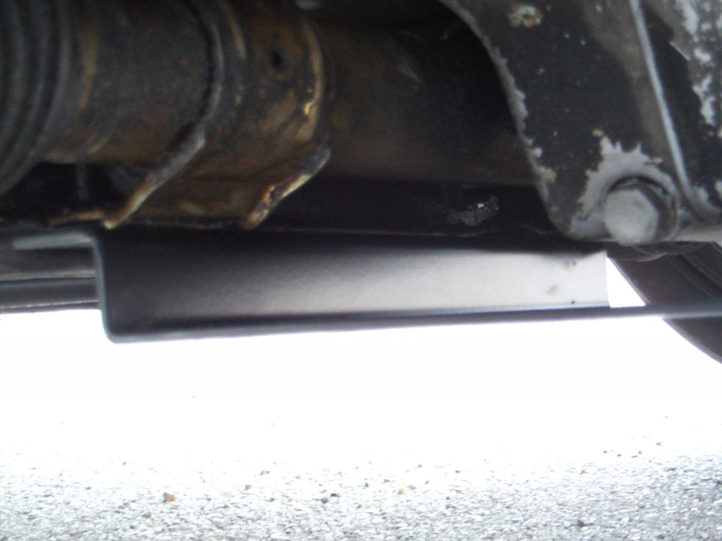

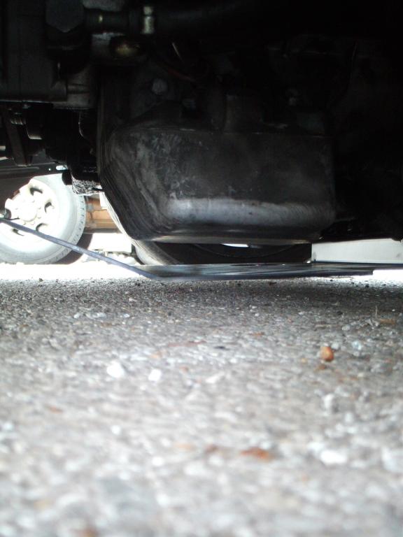

    has anybody had any problems with this skid plate not being able to reach the front? how much of a gap is it suppose to leave from the skid plate to the oil pan? because mines have a big bap. and my skid plate is like a half of a inch off the gourd maybe less than that. so when i drive i just scarp every thing. or is my car is just too low. im running lowtec 60/50 with drop hats, camber plates, with a 205/40/16 size tire...
    Here are some pics.

            A well designed skid plate is better then a replacement oil pan any day. That skid is not well designed or installed incorrectly.

              I got a skid plate off of ejnight on here. I also have the lowtec 60/50 drop. The plate on mine sits ruffly about 2 1/2" from the ground. But yes, your plate is too low.

                That's one of Eric's plates. You didn't install it right. The holes along the front should reach the radiator support. You either need to make it fit farther forward, which will draw it up from the ground, or your car is messed up.

                  There are two sets of holes the rack uses. it looks like you are using the back bolts. If you use the front holes it will move the plate forward and the front holes will line up. When you called me I asked you to send me pix of your install. I could have told you this a week ago if you had sent me these then.

                      I call either operator error on the install or possibly you ordered the wrong plate or fat chance says your subframe is so tweaked that it moved the rack back
                      all my holes up front ran perfectly along the bottom of the radiator support and it sits about 1/2" from the pan and about 2-2.5" from the ground.
