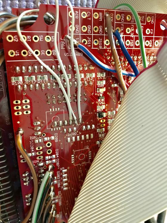

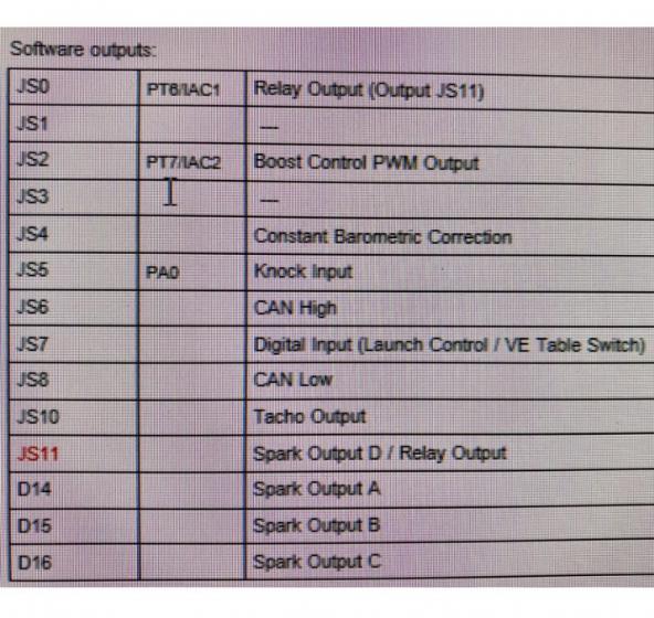

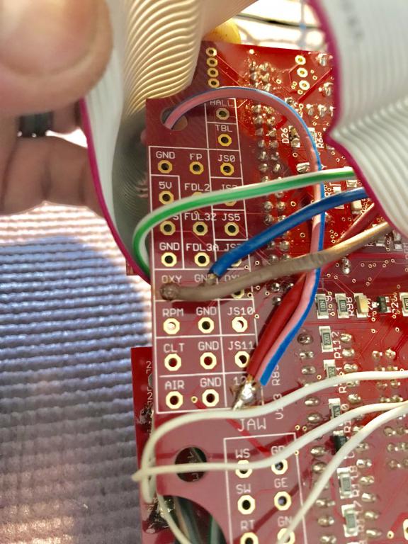

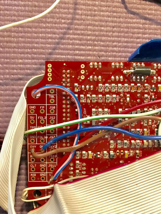

    I bought this kdfi v1.3 r89 unit used about 2 years ago. It was previously used on a m50nv turbo. I know this is similar to ms2. It’s got wires sticking out of it. I opened it and found what all these wires do, so I’m good on that part (vacuum, wideband/O2, power and usb.. My question is boost control? How do I hook up my ebc to this? The manual stated that JS2 is “Boost Control PWM Input” so does that mean that one of the wires from my ebc solenoid goes to this and the other wire goes to 12v? Or do I need to buy anything else for this to work? Pics attached.
    Additional pics
      The manual stated:
