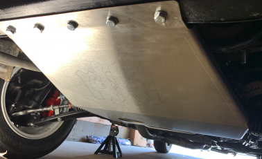

      It's a little tough to see from the angle of your photo, but that looks normal to me. The radiator support (on my car, at least) has kind of a rolled edge that made it a pain to fit the plate at first. I'm assuming this will get a little easier over time once it's bolted in place and the core support sort of bends. I went back in with a Dremel and carbide bit to widen the holes after drilling to make it a little easier. This is the only picture I have of mine installed, but it's doable after fiddling around for a while. If you have a spare jack to lift the skidplate while trying to get the bolts threaded through that makes life a lot easier.

        Yeah, looks factory/correct to me. You can see the small rolled lip all the way along the edge, indicating it hasn't been modified.

          Oh so that's how it's meant to be? I thought it started to rust and someone cut the rust off. I guess i can try and fit it again. Thanks a lot guys!
