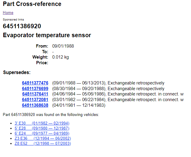

    Does anyone know of a probe that will work other than the specific part BMW number 64511386920? The reason I ask is they seem to be $170 or so and one for other models like an E39 can be had for $40. Has anyone ever looked into this?

        That sensor is basically for the de-icer, it sends a signal to the compressor when it detects a temperature drop to near freezing, to prevent the evaporator from icing up.
        The same sensor on the E30 is found on the E28, E24, E36 Z3 (coupe and roadster) as well as the Z8.
          Okay, good to know, thank you. It's interesting the same sensor is found in the Z8 as well.

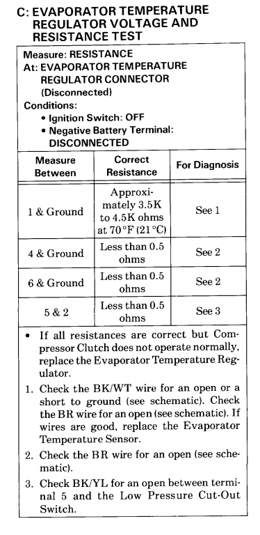

          I tested my current probe and was not able to confirm an open condition at or below 32* F but it did change to a high resistance.

            Here is the test for the sensor on the evaporator temperature regulator:

            I guess pin 1 and a ground is the resistance input the sensor sends to the regulator, i am uncertain.
            This is what Realoem shows:
