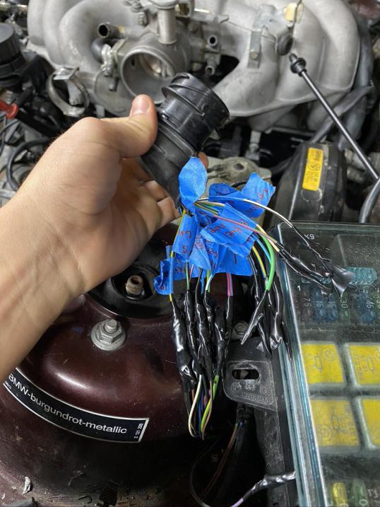

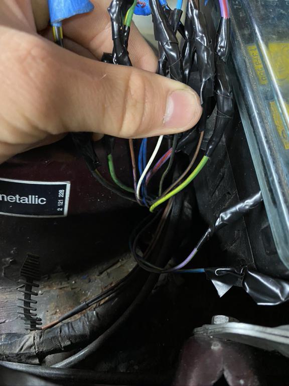

    Hey yall,
    I have been searching the internet and nearly every BMW forum page for answers regarding the rewiring for an m20 swap into a 325e. I have a 1984 chassis and a '89 325i motor. I am using the harness from the i, and everything else. I have been trying to adapt the c104 plug to the new c101 connector so the wiring harness works. However, I received the chassis without the c104 plug, so I don't have the original pinouts from a c104 connector. E30 zone wiki has been a major help, however it looks like the colors don't entirely match up, and I am a complete noob at this. 😂
    Does anyone know what I need to do to the wiring around the new c101 plug and the wire mess from the c104 plug so I can get most of my sensors functioning? I did read something that said I have to route wires from the ecu back to the plug, but I was under the impression that is only needing if you are running an older wiring loom.
    Thanks yall, I appreciate the help.
    Here is what I have done now, I believe the connections are correct, but I also have no clue soo...
ID:	9948042 Click image for larger version
  • captain confused
    • Jan 2020
    • 30
    I swapped a 90 into an 85. here is my set up for c104 & round c101
    ignore the colors that's what I used for mine.
    C104
    1 Tach: Grey/Purple Connection to Pin 9
    2 OBC Relay: Off white Connection to pin 7
    3 Econo meter: Grey/Red Connection to Pin 8
