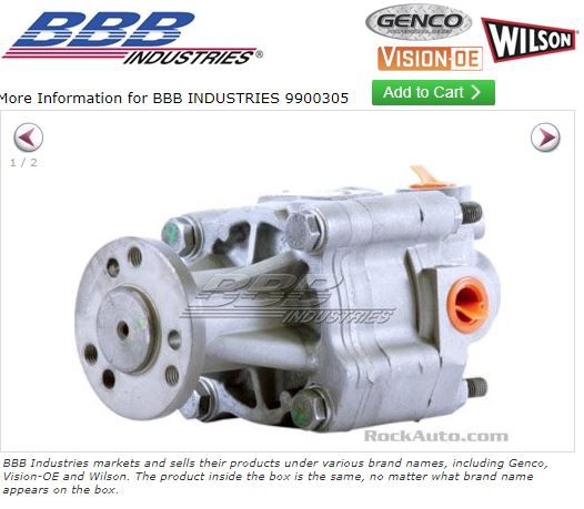

      I bought this one from Rock Auto...really liked the look of it; appears to be a reman of the original.
      I believe they are re-manufactured in the US. It even came with copper crush washers.
      It didn't fix my noisy power steering issue (ruled out the pump anyway)

        Perfect! Thanks man I ordered it, should be here Wednesday. 1990 325is Manual

          BTW I put this in. No leaks and no problems! Now I want an e36 or e46 steering rack. 1990 Brilliant Rot 325is Manual
