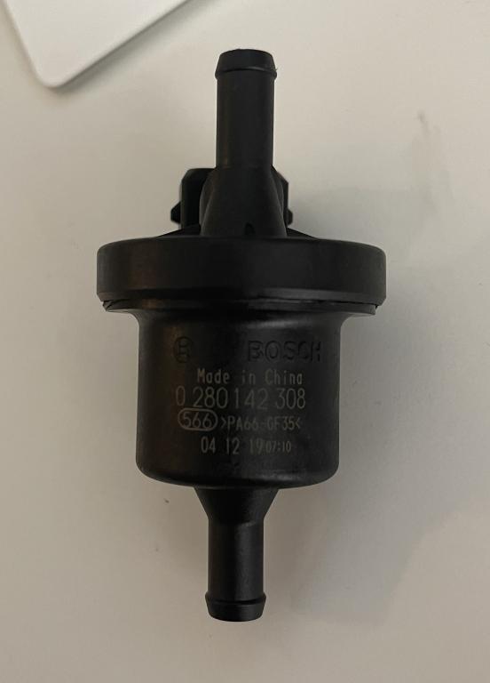

    Hi, I have a 1991 e30 325i imported from Japan
    I'm cleaning and refreshing the throttle body and replacing some vacuum hoses
    Under the throttle body, I found this purge valve that is not OEM Bosch P/N 0280142308

    It has the same 2 wire plug and hose connection on each end, but the arrow is pointing in opposite direction compared to P/N 13901711395
    Would this work without any issue if the arrow is pointing to the throttle body?

    If you reinstall it with the arrow pointing the right way I'd bet that that VAG part would work just fine.
