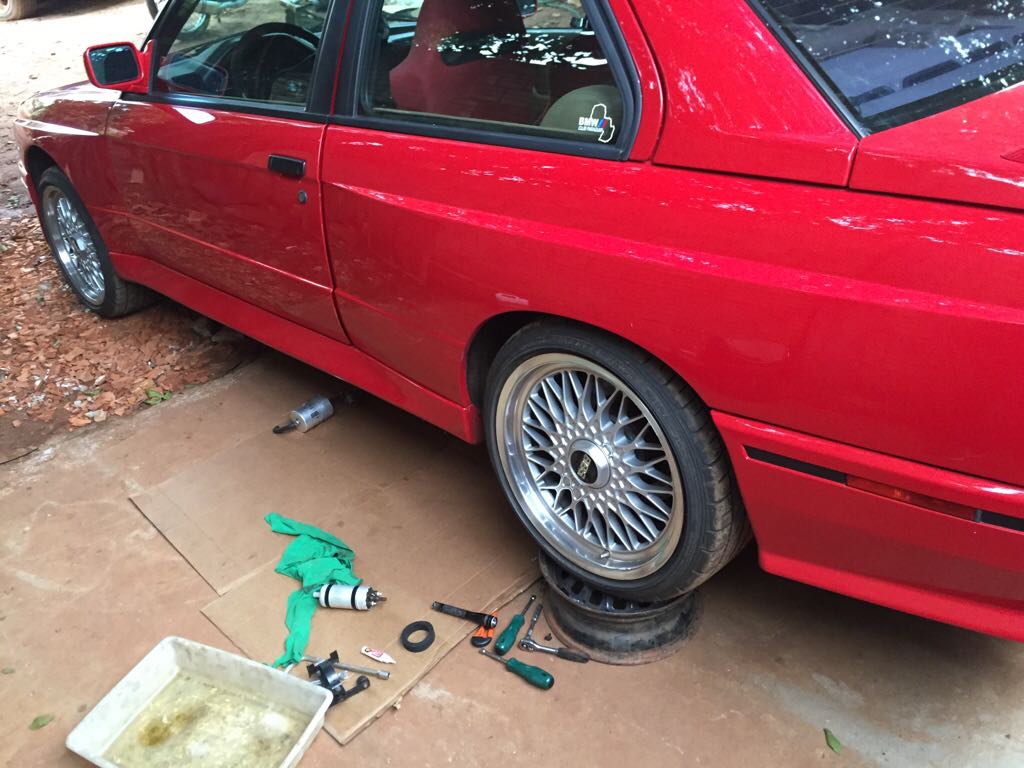

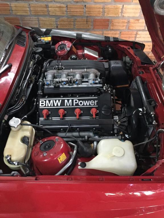

              Fortunally I've bought a very nice set of refurbish oem injector from UK! I also installed a new external fuel pump with fuel filter.. The car feels great now..
