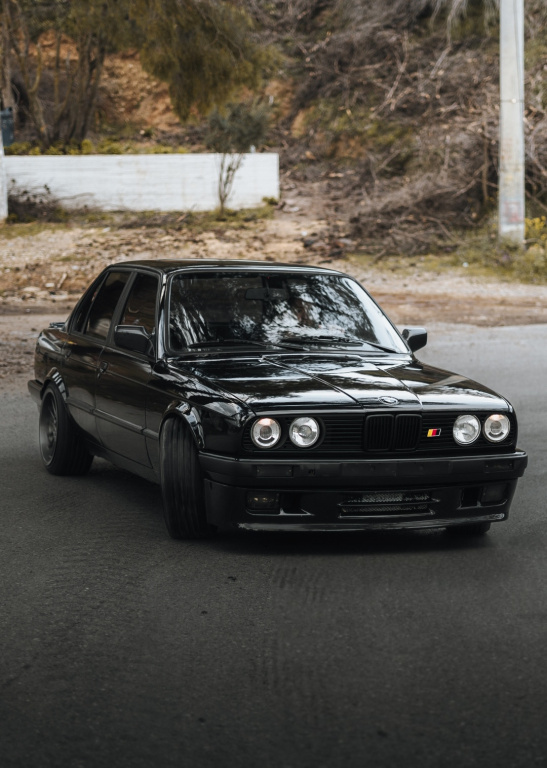

    Anyone else running the "Cybul " brand front lower control arms designed for 5X120 / E36 Z3 1.9L hubs also? Wheels are in the center of the wheel arch and all. I will be running E38 16x8 mesh wheels. Lip of the wheel is just about 29mm from front fender / straight edge / measurement. Here are a few photos. Obliviously suspension isn't compressed yet / coil overs adjusted ect. Seems like a bunch of people running E38 mesh wheels with no offset problems, some even running spacers? How? Food for thought?
