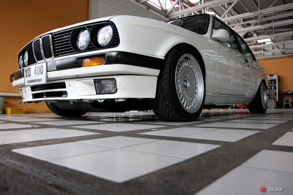

    found a guy locally with these wheels, I want them so badly.

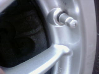

        I just bought 16" BBS Rk's and they clear the calipers as long as you position the stick on wheel weights in the right spot. check out the sweet paint job

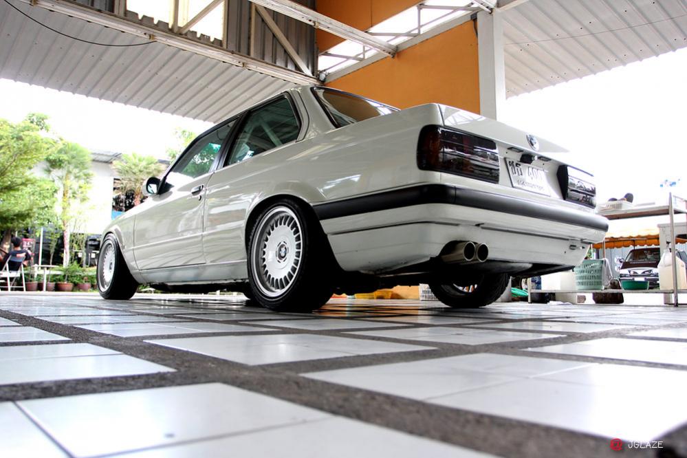

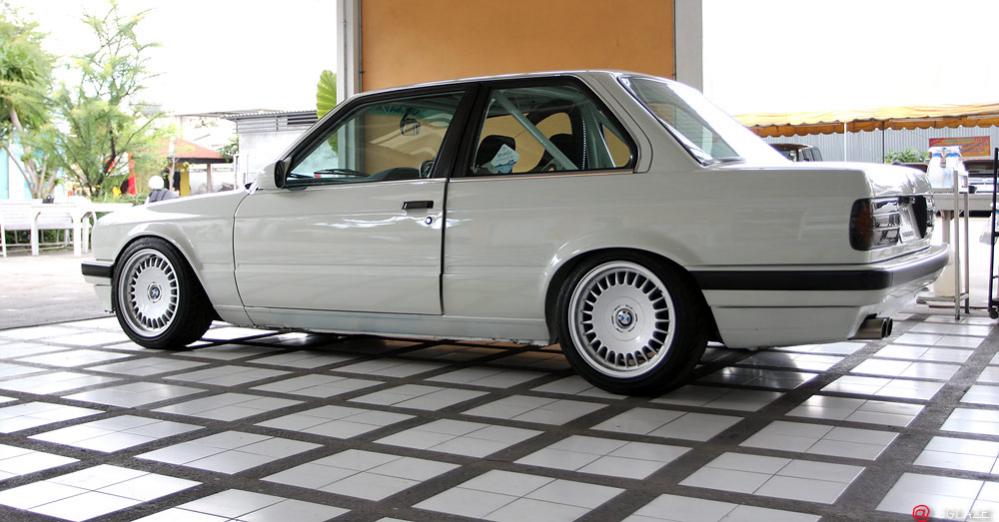

            16x7.5 ET20. Fit perfectly over e36m3 setup without any spacers, nor hubcentric rings.

                What the heck are those? They look like a weird bottlecap/style 6 hybrid, but with way too many spokes...

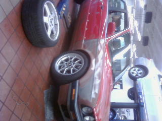

                    What about these? I need something cheap to get the car rolling ASAP.

                      NM, I got my answer a few threads down: http://www.r3vlimited.com/board/showthread.php?t=186989

                              Did you get tires on them?

                                I sorta dig em.
