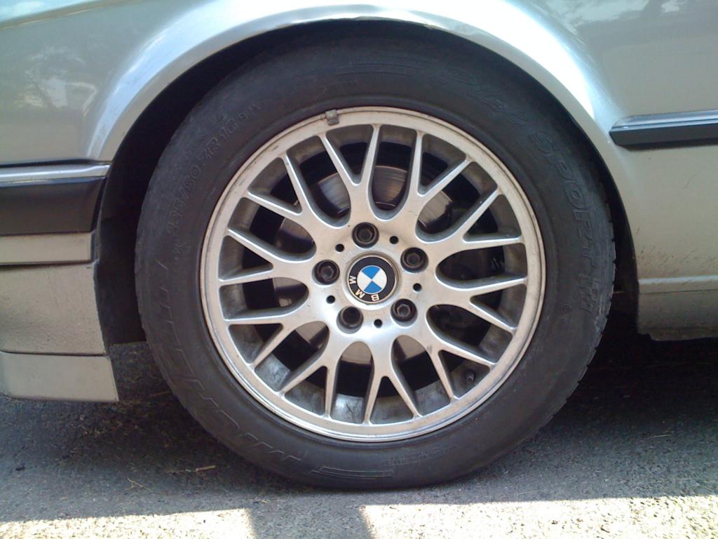

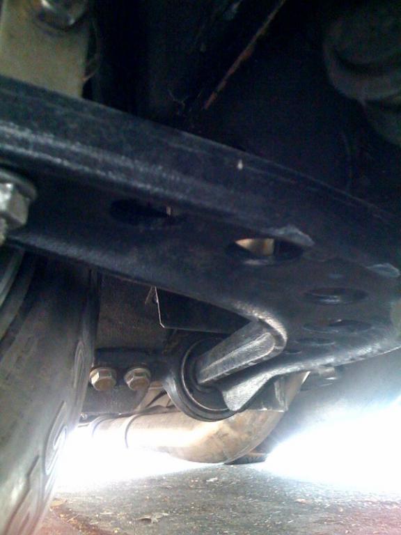

              What I can tell from my experience using a donor euro 323ti is that this ^ is correct. My front wheels are NOT centered.. I am running 225/50 16 tires with some rubbing on full lock, and I used everything from the 323ti, brakes, spindles, hubs, struts, springs, etc.. EXCEPT I did use the 96+ M3 lower control arms and E30M3 offset CAB“s,but caster won“t be correct with just these two parts. It would now be very expensive to change spindles, rotors, pads, hubs, struts, etc.. to M3 parts... so I still haven“t decided on how to fix the centering issue... but enjoying my swap every day !!

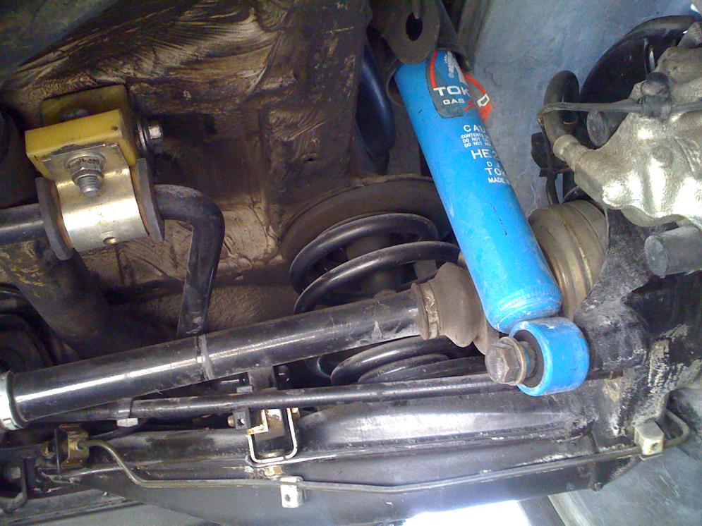

              By the way, on the back I used also everything from the 323ti, except for eibach E30 springs and E30 tokico shocks, and everything fits perfectly on the E30. I just need to have some camber adjustment on the back now, but that is due to the lowering, not the swap.

                  If you want I can post a pic of how my wheel looks right now with E36 parts, 96+ E36M3 control arms and E30M3 CABs

                          This is my 5 lug setup with euro 323ti E36 suspension, brakes, steering, engine, ABS, ASC, A/C, except for 96+E36M3 Lower Control Arms and E30M3 CAB“s. On the rear I kept my E30 Eibach springs and E30 Tokico shocks.
Name:	drivers wheel.jpg

Name:	Front CAB 2.jpg

Name:	rear eibachs and tokico HP.jpg
