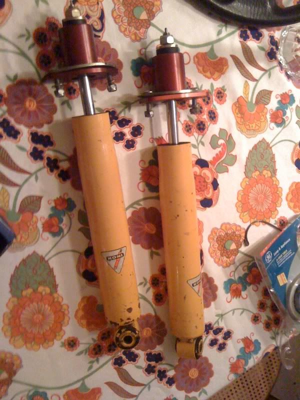

                    Yes, they make custom top adjustable rear konis (from gc kits). So I'm scrapping the whole rear bolt bracket idea. Its totally do-able but, it would just look straight up ugly as they would stick out like a sore thumb when looking at the rear.
                    I lined up my e30 bilstein sport shock with the e36 m3 koni's and measured the difference. The difference is 2.37 inches +/- some. I really want to run these e36 m3 koni top adjustables, so I'm going to think of some kind of custom shock mounts.

                              I found a solution to run my e36 m3 top adjustable rear konis in my e30.
                              not mine but bought the same exact ones brand new. Should be in by tomorrow morning.
                              Yay. =)
